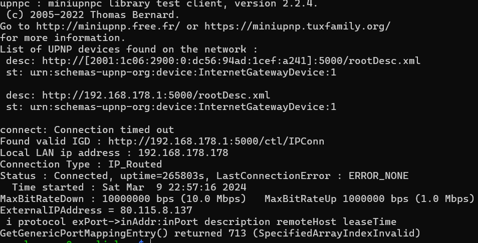

pi@raspberry:~ $ upnpc -l
upnpc : miniupnpc library test client. (c) 2005-2014 Thomas Bernard
Go to http://miniupnp.free.fr/ or http://miniupnp.tuxfamily.org/
for more information.
List of UPNP devices found on the network :
desc: http://192.168.1.1:44947/rootDesc.xml
st: urn:schemas-upnp-org:device:InternetGatewayDevice:1
Found valid IGD : http://192.168.1.1:44947/ctl/IPConn
Local LAN ip address : 192.168.1.10
Connection Type : IP_Routed
Status : Connected, uptime=1111171s, LastConnectionError : ERROR_NONE
Time started : Wed Aug 2 12:12:50 2017
MaxBitRateDown : 4200000 bps (4.2 Mbps) MaxBitRateUp 4200000 bps (4.2 Mbps)
ExternalIPAddress = 11.22.3.44
i protocol exPort->inAddr:inPort description remoteHost leaseTime
0 UDP 51413->192.168.1.10:51413 'Transmission at 51413' '' 0
1 TCP 8621->192.168.1.10:8621 'AceStream port 8621 -> 8621' '' 0
2 TCP 8622->192.168.1.10:8621 'AceStream port 8621 -> 8622' '' 0
3 TCP 51413->192.168.1.10:51413 'NAT-PMP 51413 tcp' '' 3474
