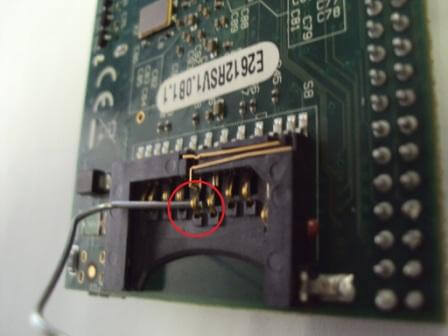

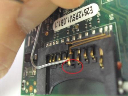

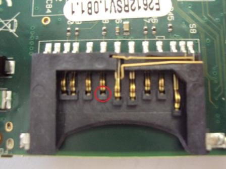

Hace tiempo vi fotos de una persona que reparó los contactos del lector de tarjetas:
It could be that the SD memory card is not making proper contact with the Raspberry Pi. Look at the SD card holder on the Raspberry Pi carefully. At first glance it may look fine, but the contacts must be springy and they must protrude at least 2mm as measured from the lower edge of the holder to the top of the contact bulge. Variations happen due to the solder process and the type of holder used. Some of the solder residue falls into the contact cavity, restricting the springiness and the height that the contact protrudes. You can fix this yourself, but remember you can void your warranty. The contacts are delicate, so be careful. Insert a needle pin under the contact bulge and pull lightly up until the one end of the contact unclips. Clean the cavity where the contact unclipped from any solder or other residue by blowing into the cavity. Clip the contact back into the cavity by lightly pushing it into the cavity. Do this for all the contacts. Refer to these photos:
Te digo esto en el caso de los 4 parpadeos.
