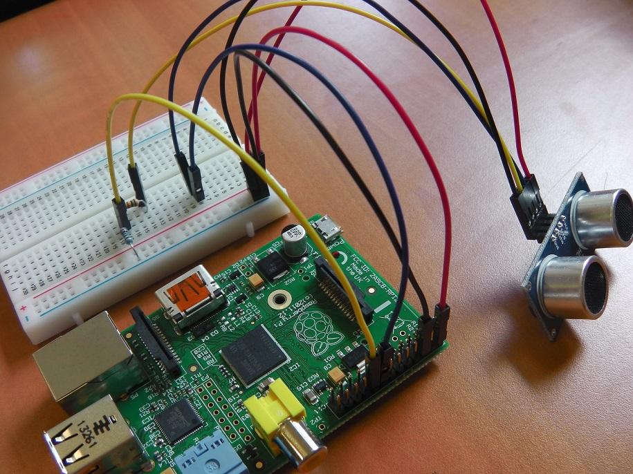

- He visto que la RBPi trabaja a 3.3V y el sensor HC-SR04 al ser de Arduino es de 5V. Ese es la primera barrera que me encuentro. Sé que habría que igualar los voltajes mediante resistencias, pero mi idea de electrónica es limitada.

Sobre el tema del sensor, Esto es lo que he podido obtener de información sobre el sensor HC-SR04:
The HC-SR04 Ultrasonic sensor we’ll be using in this tutorial for the Raspberry Pi has four pins: ground (GND), Echo Pulse Output (ECHO), Trigger Pulse Input (TRIG), and 5V Supply (Vcc). We power the module using Vcc, ground it using GND, and use our Raspberry Pi to send an input signal to TRIG, which triggers the sensor to send an ultrasonic pulse. The pulse waves bounce off any nearby objects and some are reflected back to the sensor. The sensor detects these return waves and measures the time between the trigger and returned pulse, and then sends a 5V signal on the ECHO pin.
ECHO will be “low” (0V) until the sensor is triggered when it receives the echo pulse. Once a return pulse has been located ECHO is set “high” (5V) for the duration of that pulse. Pulse duration is the full time between the sensor outputting an ultrasonic pulse, and the return pulse being detected by the sensor receiver. Our Python script must therefore measure the pulse duration and then calculate distance from this.
IMPORTANT. The sensor output signal (ECHO) on the HC-SR04 is rated at 5V. However, the input pin on the Raspberry Pi GPIO is rated at 3.3V. Sending a 5V signal into that unprotected 3.3V input port could damage your GPIO pins, which is something we want to avoid! We’ll need to use a small voltage divider circuit, consisting of two resistors, to lower the sensor output voltage to something our Raspberry Pi can handle.
O sea que es el pin echo el que devuelve los 5V a la RBPi, lo cual puede quemarla, por eso recalca que hay que usar un divisor de voltaje. Lo bueno es que especifican la fórmula para calcular las resistencias necesarias, así que intentaré seguir los pasos. Soy un poco pez, pero muy enreda, así que espero avanzar sin necesidad de quemar la placa y tener que verme comprando varias para sacar el proyecto adelante! :suerte
Lo que saco en claro es que hay que hacer un divisor de voltaje mediante un par de resistencias. Os paso el enlace que he podido encontrar al respecto:
https://thepihut.com/blogs/raspberry-pi ... spberry-pi
